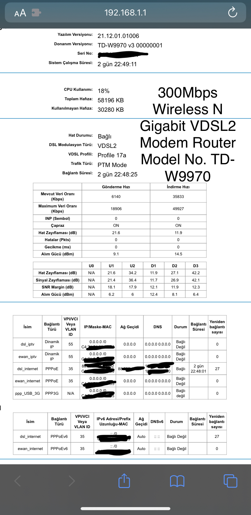

bende bu kısım çıkmıyor başka sürümmü var sizde bende böyle
xDSLFwVersion: FwVer:5.12.21.0_B_A60901 HwVer:T14.F7_0.0
Line State: Up
Modulation: ITU G.993.2(VDSL2)
Annex Mode: ANNEX_B
INP downstream: 0
INP upstream: 0
shineGINPdownstream: 0
shineGINPupstream: 0
reinGINPdownstream: 0
reinGINPupstream: 0
TPSTC type: 64/65B PTM TC
near-end interleaved channel bit rate: 0 kbps
near-end fast channel bit rate: 99996 kbps
far-end interleaved channel bit rate: 0 kbps
far-end fast channel bit rate: 8192 kbps
near-end FEC error fast: 0
near-end FEC error interleaved: 0
near-end CRC error fast: 0
near-end CRC error interleaved: 0
near-end HEC error fast: 0
near-end HEC error interleaved: 0
far-end FEC error fast: 0
far-end FEC error interleaved: 0
far-end CRC error fast: 0
far-end CRC error interleaved: 0
far-end HEC error fast: 0
far-end HEC error interleaved: 0
DSL uptime :1 day, 15:11, 18 secs
DSL activetime :0 min, 21 secs
Downstream:
relative capacity occupation: 100%
noise margin downstream: 19.2 dB
output power upstream: 0.2 dbm
attenuation downstream: 4.9 dB
Upstream:
noise margin upstream: 32.1 dB
output power downstream: 13.9 dbm
attenuation upstream: 0.1 dB
Bit table:
carrier load: number of bits per tone
tone 0- 31: 00 00 00 00 00 00 00 00 00 00 00 00 00 00 00 01
tone 32- 63: 00 55 67 76 67 77 77 77 87 98 98 88 99 99 aa aa
tone 64- 95: 99 99 99 9a aa aa aa aa ba aa bb aa aa ab ba ab
tone 96-127: bb bb bb bb bb bb ab bb bb bb bb bb bb bc bb bb
tone 128-159: cb cb cb bb cc cc cc bb cb bc cc cc cc cb cc cc
tone 160-191: cc cc cc cc cc cc bc cc cc cc cc cc cc cc cc cc
tone 192-223: cc bd cc cc cc cc cc cc cc cc cc cc cc cd cb cc
tone 224-255: cc cc cc cc cc cc cc cc cb cc cc cc cc cc cc cc

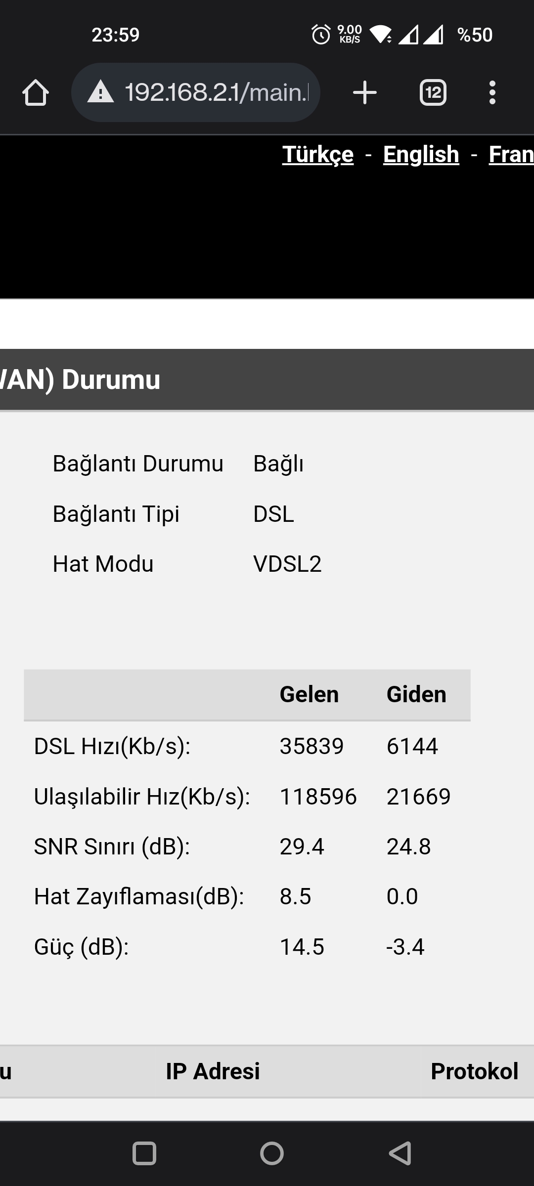

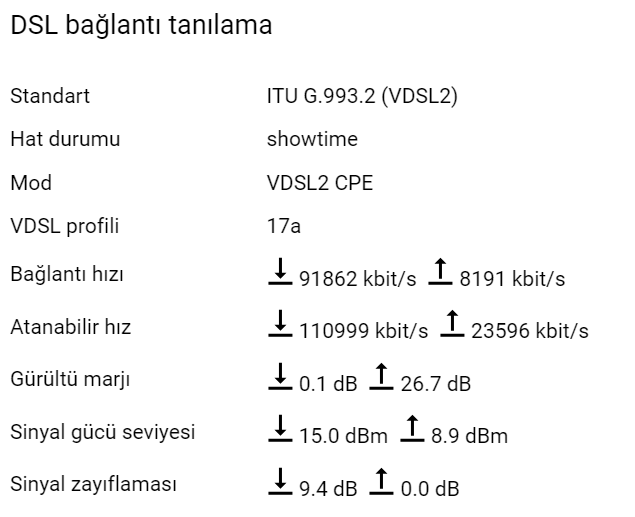

Arkadaşlar, benim hat değerlerim aşağıdaki gibi.. Enteresan olan şu. Normalde bu 0.1 oranı ile sürekli hat kopması yada hız düşüşü gibi şeyler yaşamam gerekirken, haftalardır, hatta aylardır en ufak bir sorun yaşamıyorum. Sabah ve akşam hız testi yapıyorum, 84-85mbit hız alıyorum, download hızlarım keza gayet iyi. Dolayısıyla bu gürültü marjı değeri yanlış mı gösteriyor diye düşünmeye başladım artık. Fikri olan var mı?

Yanlış gösterdiğini sanmıyorum, benim de hattım 1-2 SNR ile açık kalabiliyor, ama komşu modemi yeniden başlatsa kopuyor.
Modeme giren telefon kablosunu elinizle bi oynatın, eğer bağlantı koparsa hoş değil. Kopmaması lazım.
Hattı bu kadar sınırda kullanmak hız açısından güzel ama ping artışları yaşanabilir, ben olsam SNR'yi 5in altına düşürmem.

Multiplayer oyun da oynuyorum playstation ile. Şimdiye kadar hissettiğim herhangi bir sorun olmadı. Merak ettim sadece. Normalde kopması lazım sürekli.

keenetic cihazlar bu konularda çok iyi, normalde modemler 6 değerinin altında koparlar. Ama keeneticler çok düşük snr'lerde bile tutunabiliyor. Tabi sizin de ayrı bir şansınız var

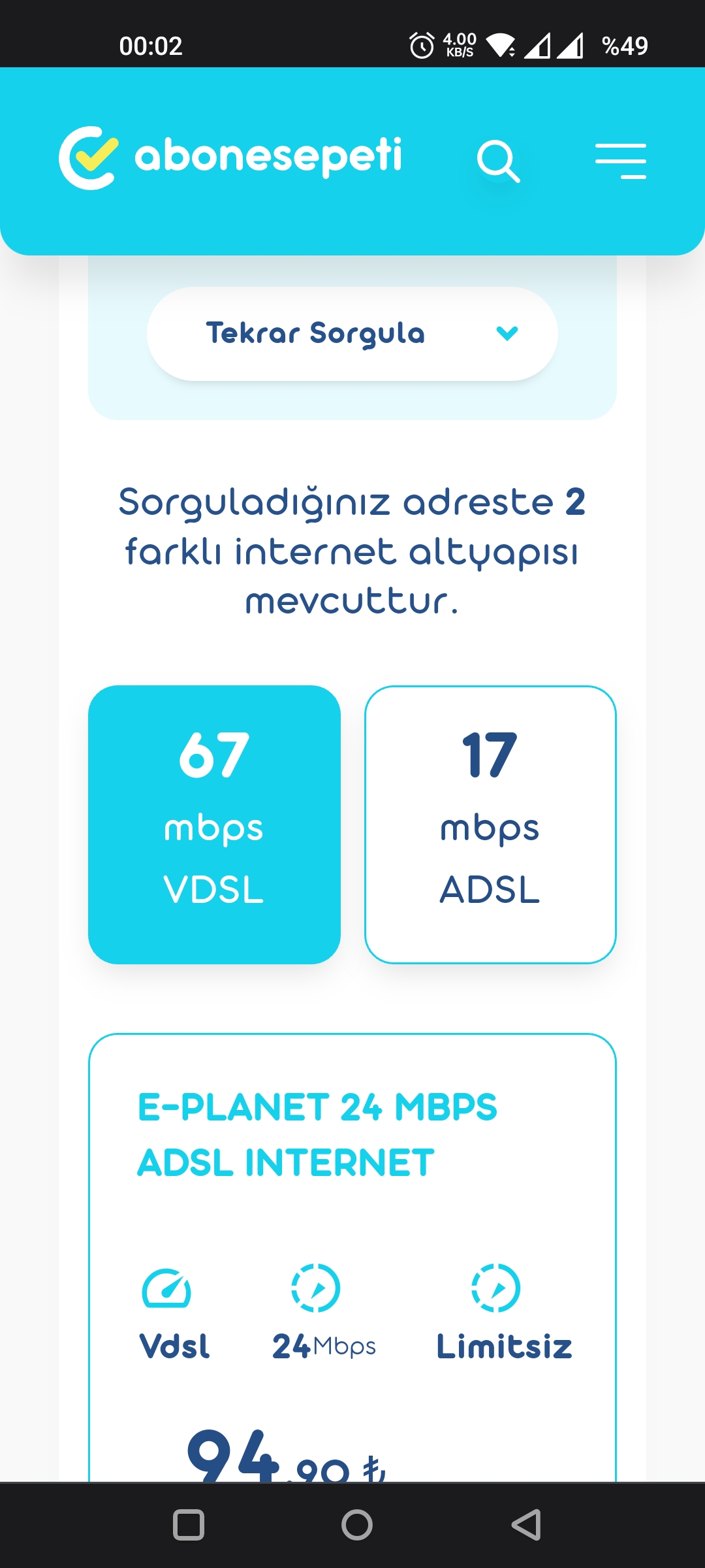

merhaba arkadaşlar bir sorum olacaktı.hat değerlerim ve altyapı sorgulama sonuçlarım sorum ise:
aslında hattım 100 mbit destekliyor ama tt nin güncelleme yapması mı gerekiyor?
yoksa gerçekten benim alabileceğim maksimum hız 67 mbit mi?
bu arada saha dolabı 197mt uzakta

şuan 100 rahat sorunsuz alırsın zamanla yoğunluk artarsa hattında sıkıntı olursa düşebilir ama

sağolun hocam. ama iss 67 mbit gözüktüğü için 100 vermez sanıyorum. tt nin güncellemesi mi yapması mı gerek nasıl yaptırabilirim acaba.
bi de 100 verdi iss diyelim 67 mbit e sınırlanırsa boşuna bi ton para ödeyeceğim :( ne yapacağımı bilemedim

saha dolabı sınırlandırılmış olabiliyor ama pek karşılaşmıyoruz 78-88 mbit'lere sınırlandırıyorlardı sınırlı çıkarsa eğer şikayet edince açıyorlar

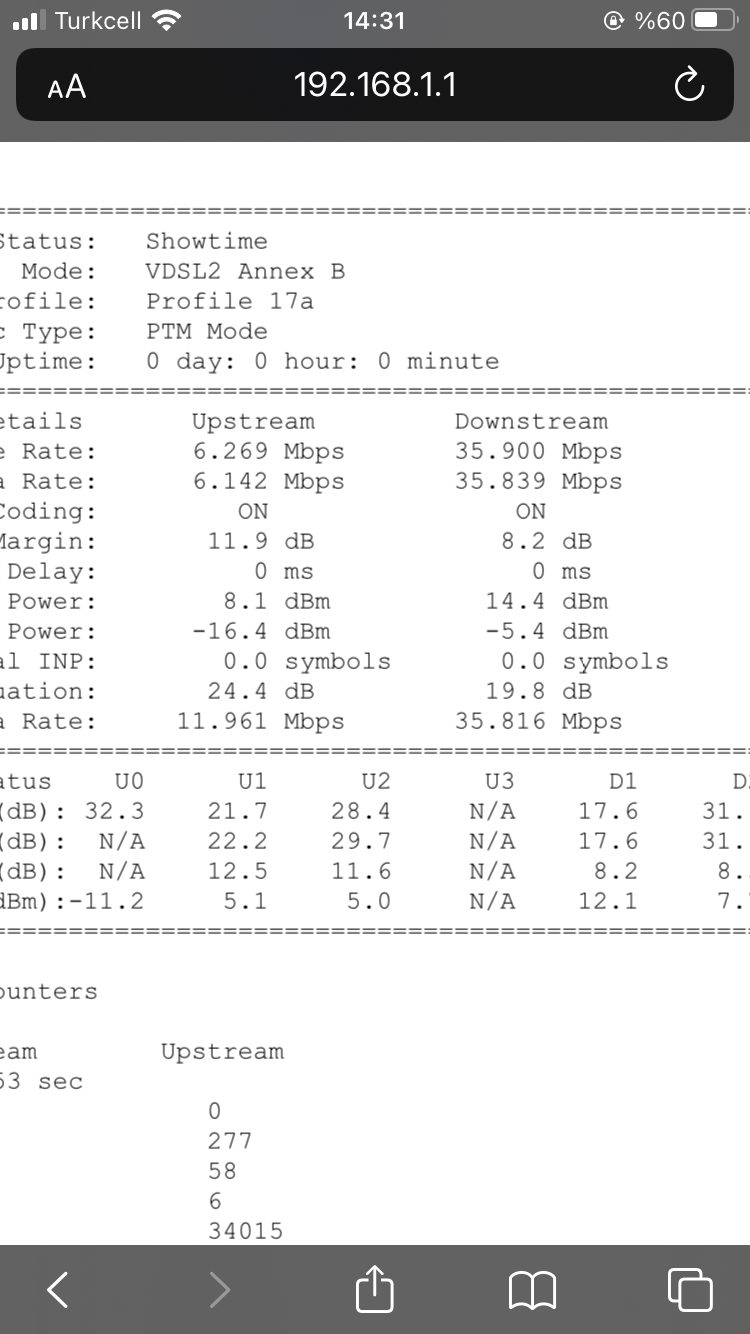

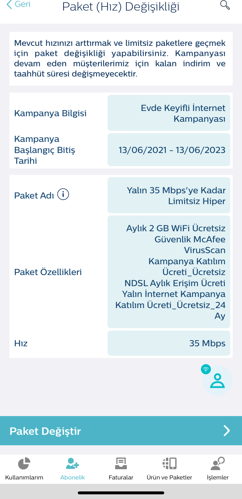

Paket 35/6 alınan 33/5-6 aylık 120-125 TL
Daha fazlasını zorlarsam sanırım sıkıntılar yaşamaya başlarım yıllardır daha yeni son 2-3 aydır vdsl e geçtim
Bu arada modem değiştirmeyi düşünüyorum Wi-Fi 6 5 ghz falan ama bu internete fazla abartı olur diye şimdilik erteliyorum karar veremedim
Değerler nasıl sizce

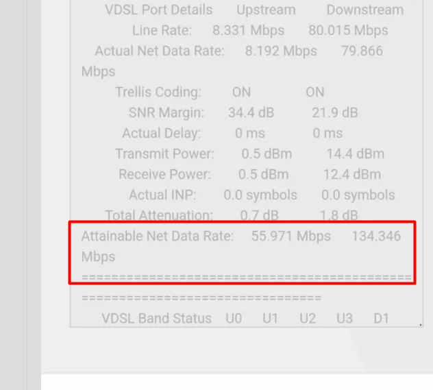

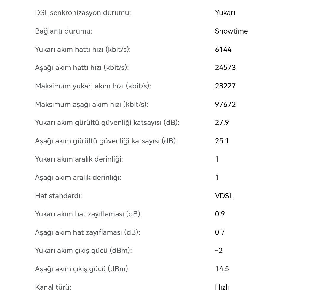

Netspeed 75 Mbps VDSL kullanıyorum. Hat değerlerim şu şekilde;
Bu hat değerleri ile en fazla kaç Mbps hız alabilirim?

yeni sürüm çıkmış onu yükledim ondada yok

Hmmm.. Bilemiyorum vallahi hocam. Bende o şekilde çıkıyor.

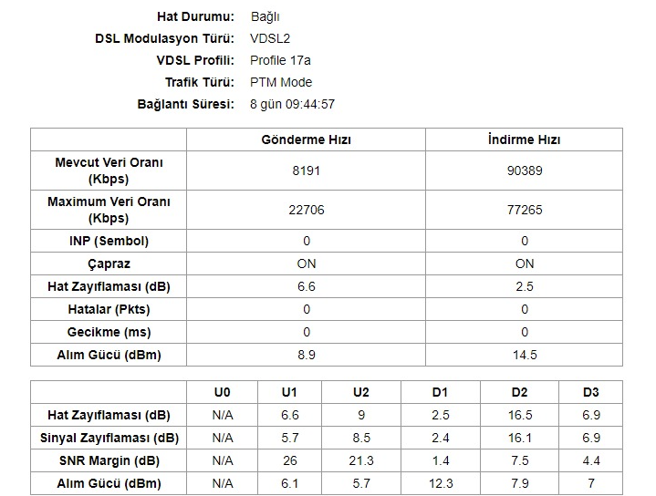

Bu durum nasıl yaşanmış olabiliyor aylarca 75'ten fazla alamazsınız diyen türknet yanlışlıkla 90k vermiş ve hiçbir sıkıntı olmadan kullanabiliyorum.
