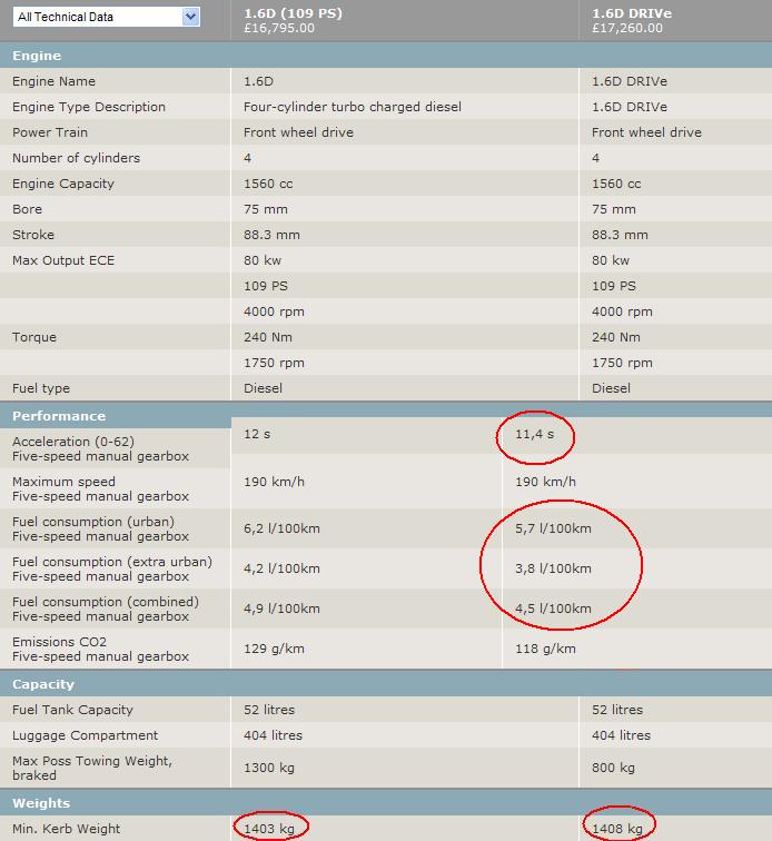

DRIVe versiyonunda hızlanma 0,6sn ve yakıt tüketiminde yaklaşık %10 iyileşme sağlamış.
motorda mekanik bir fark yok ise tüm 1.6D lere aynı uygulama yapılabilir mi acaba? şimdi bunu çok merak ettim doğrusu?
dizeller 1.6D ve DRIVe diye 2 farklı versiyonla satılıyor.. acaba Türkiyede nasıl olacak???

arkadaşlar gerkeçten kusura bakmayın bu DRIVe olayına fena taktım bugün..
Volvocular ne yaptılar da motoru 1,6d ile aynı teknik verilere sahip olmasına rağmen hem yakıtı düşürüp hem de daha hızlı yaptışar diye araştırdım biraz.. kaynaklar ingilizce ama isteyen olursa özetle Türkçeye de çevirebiliriz.
olay şu:
Reduced air resistance:
Chassis height reduced by about 10 mm. Same comfort setting as the standard car.
Spoiler at the front, the same as on the T5 (S40 and V50).
Covered radiator grille. Behind the characteristic Volvo grille there is a wind-deflecting panel that provides better aerodynamics inside the engine compartment.
Wind deflectors in front of the front wheels.
Aerodynamically optimised wheels of special design. Available in 15 and 16 inch sizes.
Underbody panels for more efficient airflow under the car as well (C30).
Unique rear spoiler (C30). The Volvo S40 DRIVe has the same spoiler as the T5 and D5 models.
New rear bumper (C30).
Lower rolling resistance:
All the cars are equipped as standard with a new generation of Michelin tyres with low rolling resistance. Available for 15 and 16 inch wheels.
Higher ratios:
Gearbox with altered ratios for third, fourth and fifth gears.
More efficient driveline:
Optimised engine cooling, engine management and power steering.
New transmission oil with lower friction.
Gearchange indicator in the information display.
"Changing the transmission oil gives us a 0.75 percent lower fuel consumption. Tyres with low rolling resistance save another two percent. Each of these measures may seem rather modest, but it is important to look at the whole picture. Taken together, all the small adjustments have helped us achieve our aim, with emissions below 120 g/km for all three cars. Without in any way compromising on either driving properties or comfort, which was an important requirement," says Magnus Jonsson, Senior Vice President, Research & Development at Volvo Cars.
eğer Türkiye ye gelecekse almak isteyecekler için forumumuz bilgi kaynağı olabilir diye düşünüp ekledim.

anladığım kadarıyla
1- aracın daha performanslı olması söz konusu değil, çünkü motorun teknik özellikleri ve drive ile normal versiyonun ağırlıkları aynı (hatta drive 5 kg daha ağır). 100 km ivmelenmesindeki fark vites oranıyla alakalı olsa gerek diye düşünüyorum, çünkü ilk 2 vites kısalmış son 3 4 ve 5 uzamış, bu da ara hızlanmalarda dezavantaj yaratacaktır.
2- aracın römork çekme kapasitesi drive da 500 kg gibi çok büyük bir seviyede düşmüş (1300e 800 kg nerdeyse %40), bu da aktarma organının tüketimi düşürmek için daha düşük sürtünmeye sahip fakat daha dayanıksız olduğuna işaret ediyor bana göre.
3-tam dönüş çevresi 0,5 metre artmış, ama bunun eklenen spoilerler falan ilgisi yok çünkü t5 te bile bir değişiklik yok sadece drive da 10,6a 11,1 metrelik bir artış söz konusu , açıkcası buna bir anlam veremedim ama manevra kabiliyetinin normale nazaran düşük olması kaçınılmaz.
4- yenilenen taban panelleri ve aerodinamik eklentiler şüphesiz çok olumlu gelişmeler ama açıkcası bu drive modelinin daha yüksek bakım giderlerine neden olacağını ve yol tutuşunun daha zayıf olacağını düşünüyorum, çünkü düşük tüktimli lastik demek düşük yol tutuş demek aynı zamanda.
5- ingiltere fiyatı 500 pound daha pajalı türkiyeye gelirse 900-1000 euro daha pahalı olur,
6- emisyon üzerinden vergilendirilen ülkeler için çok avantajlı
