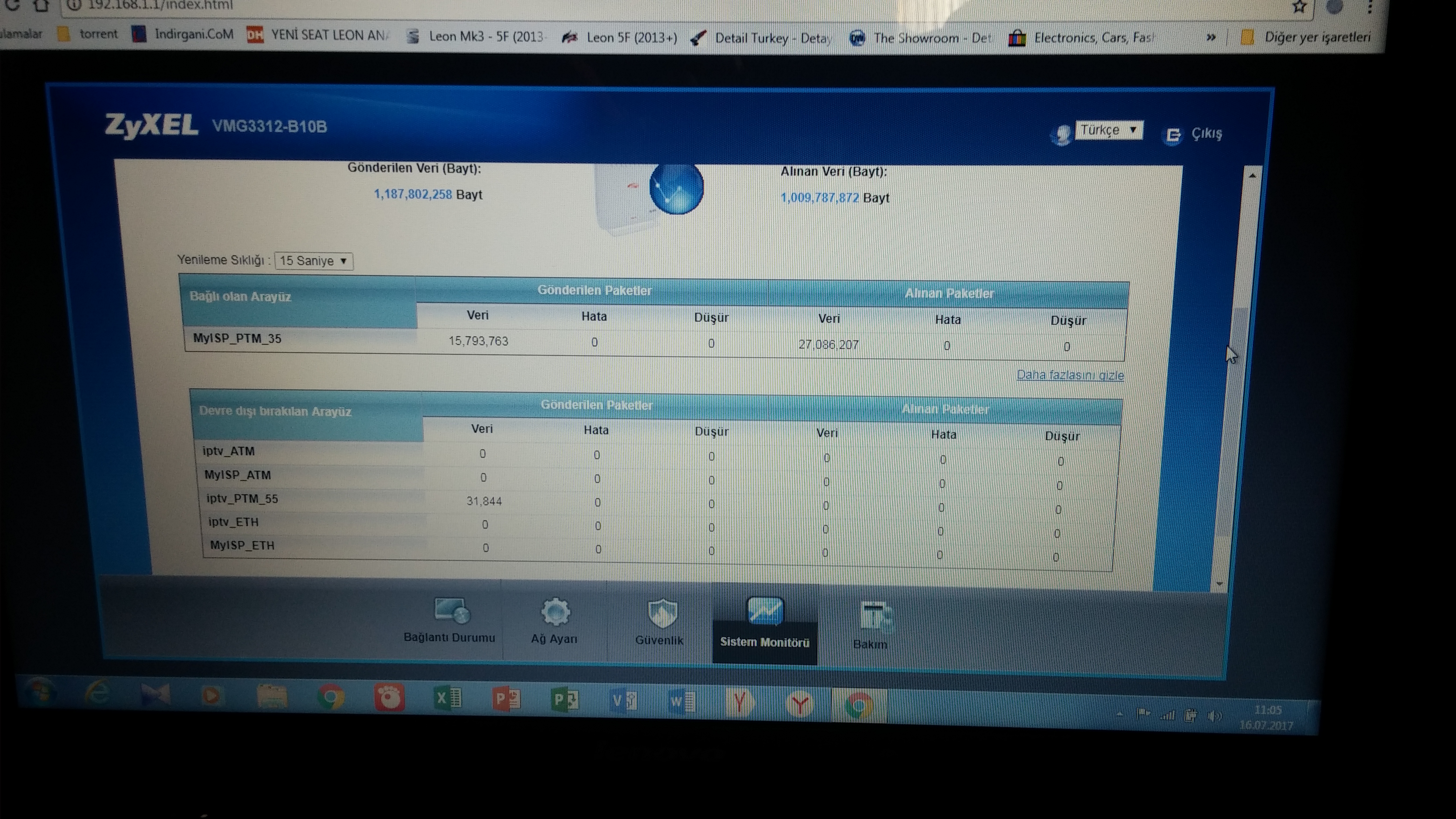

Orijinalden alıntı: ThesadisT
Orijinalden alıntı: entropi13
Bugun itibariyle ttnetten turknete gecisim tamamlandi modeme kullanici.adi ve sifresini girdim normalde 35mbit akn siz internet alacagim soylendi fakat.hiz testlerinde max 16mbit i gordum. Modemim ttnetin verdigi zyxel vmg3312-b10b. Modeme yapman gereken bir ayar varmi modeme giren hizi nasil goruyorsunuz. Deneyimli arkadaslarin yardimini bekliyorum
Modem değerlerini paylaşın bu şekil nedir ne değildir bilemeyiz. Modemini kullanmadım ama sistem bilgisi sekmesinde olması lazım.
VDSL Training Status: Showtime
Mode: VDSL2 Annex B
VDSL Profile: Profile 17a
Traffic Type: PTM Mode
Link Uptime: 0 day: 17 hours: 51 minutes
VDSL Port Details Upstream Downstream
Line Rate: 4.125 Mbps 18.306 Mbps
Actual Net Data Rate: 4.095 Mbps 18.260 Mbps
Trellis Coding: ON ON
SNR Margin: 10.0 dB 8.8 dB
Actual Delay: 0 ms 0 ms
Transmit Power: 6.0 dBm 13.1 dBm
Receive Power: -12.5 dBm -7.4 dBm
Actual INP: 0.0 symbols 0.0 symbols
Total Attenuation: 18.6 dB 20.7 dB
Attainable Net Data Rate: 5.159 Mbps 18.700 Mbps
VDSL Band Status U0 U1 U2 U3 D1 D2 D3
Line Attenuation(dB): 8.6 50.1 N/A N/A 20.3 65.2 89.4
Signal Attenuation(dB): 8.6 49.0 N/A N/A 20.3 65.1 N/A
SNR Margin(dB): 10.6 10.0 N/A N/A 8.8 8.6 N/A
Transmit Power(dBm):- 4.0 5.6 N/A N/A 12.8 2.9 N/A
VDSL Counters
Downstream Upstream
Since Link time = 51 min 19 sec
FEC: 7200 0
CRC: 1405 0
ES: 805 0
SES: 1 0
UAS: 0 0
LOS: 0 0
LOF: 0 0
LOM: 0 0
Latest 15 minutes time = 6 min 47 sec
FEC: 4 0
CRC: 3 0
ES: 3 0
SES: 0 0
UAS: 0 0
LOS: 0 0
LOF: 0 0
LOM: 0 0
Previous 15 minutes time = 15 min 0 sec
FEC: 12 0
CRC: 20 0
ES: 18 0
SES: 0 0
UAS: 0 0
LOS: 0 0
LOF: 0 0
LOM: 0 0
Latest 1 day time = 17 hours 51 min 47 sec
FEC: 7200 0
CRC: 1405 0
ES: 805 0
SES: 1 0
UAS: 27 27
LOS: 0 0
Burasimidir hocam
