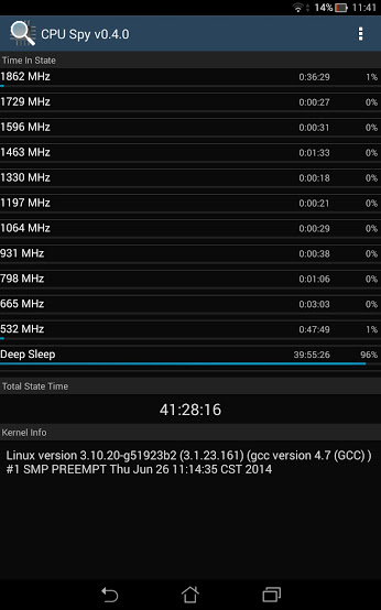

Regarding the Deep Sleep problem, me and another guy from the other thread related to this device in the Android Q & A section have this problem too. It seems that Wi-Fi being turned off is causing this problem. If Wi-Fi is on, the tablet enters deep sleep, if it's off (or if something is turning it off, like for example the battery saver Ultra Power mode), then Android OS is keeping it awake. Keep Wi-Fi on in any conditions, uncheck the "check for connections even if Wi-Fi is off" (something like that) option in Wi-Fi options, select the option to always keep Wi-fi on, even in Deep Sleep and don't use the Power Saver or either have it on the second power saving mode (the one that optimizes, but keeps Wi-Fi always on). See if this works for you too.
@ people saying that they don't have this problem, can you turn off Wi-Fi and use Ultra Mode Saving to check this issue for a bit? It might be a general issue and if it is, I want to call Asus and tell them about the problem. Maybe they can find a fix for it.
Cihazı derin uykuya gecmesini wifi seceneginin kapalı olması etkiliyor, acık bırakmayı deneyin diyor. Wifi açıkken deep sleepe gecebiliyor ama off iken geçemiyormus.. Güç koruma modlarını secmeyin, secseniz de wifi açık olanu tercih edin diyor..

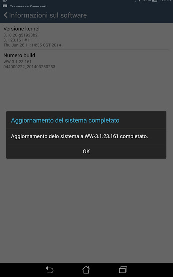

Yurtdısında biri 3-5 gun once 5 mblık bir guncelleme aldıgını ve akabinde cihazın deep sleepe geçtigini yazmıs
6 Eyl 2014
asus memopad 7 Me176cx 4.4.2 had problem DeepSleep, and then drained battery !! I received the day before yesterday an update from a 5mb! now goes DeepSleep
