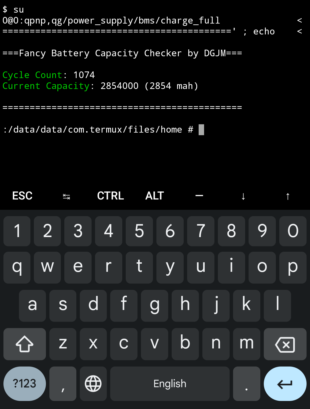

Batarya değerini nasıl görüyoruz hocam?
Bu mesajda bahsedilenler: @Ordinaryus1 , @Nf
3 yıl
Root sonrası termux yüklüyoruz.
İlk komut su ve enter, izin verince aşağıdaki kodu girelim,
export bat_counter=$(cat /sys/devices/platform/soc/c440000.qcom,spmi/spmi-0/spmi0-00/c440000.qcom,spmi:qcom,pm6150@0:qpnp,qg/power_supply/bms/cycle_count) && export bat_chrg_full=$(cat /sys/devices/platform/soc/c440000.qcom,spmi/spmi-0/spmi0-00/c440000.qcom,spmi:qcom,pm6150@0:qpnp,qg/power_supply/bms/charge_full
) ; sleep 0.5 && export bat_cap_rnded_off=$(echo "$bat_chrg_full" | sed 's/...$//') && echo ; echo '===Fancy Battery Capacity Checker by DGJM===' ; echo ; echo -e "\e[0;32mCycle Count\e[0m: $bat_counter" ; echo -e "\e[0;32mCurrent Capacity\e[0m: $bat_chrg_full ($bat_cap_rnded_off mah)" ; echo ; echo '============================================' ; echo
