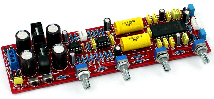

Araştirdim aşağidaki preamp devrelerden birini alamaya karar verdim .. Sadece ne5532 li devre
1.
Assembled NE5532 Tone Peramp Board
With original NE5532
Parameters:
1. Input voltage: AC12V-0-AC12V or AC15-0-AC15V
2. Potentiometer from left to right: Volume - bass - midrange - treble
4. PCB Size: 146 * 68MM

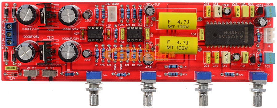

2.
NE5532 + LM 4610 DEVRELİ KART 3d ve loudness swiçleri var bu kartta diger karrta 3d ve loudness özelliği yok
LM4610 is the United States after the introduction of NS HI-FI and a LM1036 level, is an ideal alternative to LM1036 products, it is also the use of DC voltage to adjust the two channel volume, high pitched, bass, balance. The IC is based on the LM1036 3D multidimention regulation, it also comes with a loudness switch, the human ear characteristic curve to compensate for small volume in the.
n Using original LM4610N+NE5532
n Electrolytic capacitor signal main circuit using Taiwan famous brand, the main filter capacitor using Nikon special electrolytic capacitor capacity of 4 x 10000UF, full wave bridge rectifier circuit, to ensure a steady stream of power support.
n Resistance selection of five rings metal resistance, the main loop of the precision of 1% of the five rings of metal film resistance,To ensure a good signal to noise ratio.
n PCB using 1.6mm thick double-sided plate, 2 a copper thickness, tin spraying process, to ensure that the size of the current through the performance of the good. First class PCB quality.
n The use of fully enclosed dust resistance, the performance is more stable, more durable than ordinary potentiometer!
n Coupling capacitor using 3.3UF/100V MET
n Switch S1 3D audio switch, S2 switch for loudness.
Basic parameter:
PCB size: 177*52MM
Power supply voltage: AC12V-0-AC12V or AC15V-0-15V
Potentiometer distance: left to right 35mm*35mm*35mm
Potentiometer function: bass, high pitched, balanced, volume
