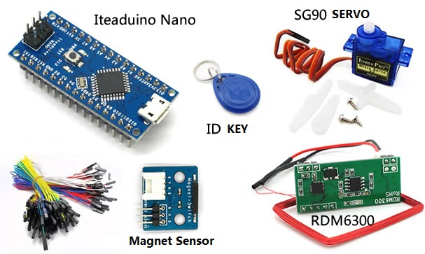

Components:
RDM6300: $5.5https://www.itead.cc/rdm6300.html
SG90 Servo: $7 https://www.itead.cc/tower-pro-airplane-9g-sg-90-mini-servo.html
Iteaduino Nano: $5.5https://www.itead.cc/iteaduino-nano.html
Magnet Sensor: $1.5https://www.itead.cc/prototyping/electronic-brick/sensor-brick/electronic-brick-magnetic-sensor-switch-brick.html

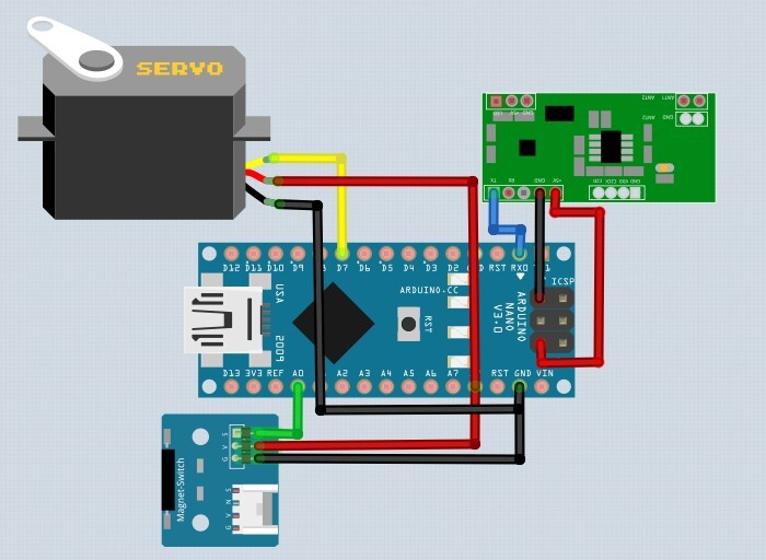

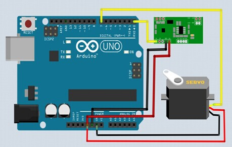

Please assemble the modules according to the following picture.
Iteaduino Nano
Iteaduino UNO

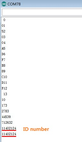

Place your card on the coil of RDM6300, then you can open the Arduino IDE’s serial monitor to see what the card ID number is.
Write down the card ID number. You should revise the demo by typing these numbers in it later.

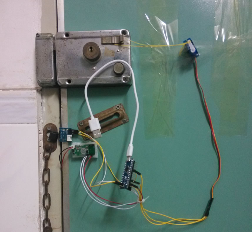

After revising demo and uploading again, you can install them on the back of your home door. Just like the video we show at the beginning, you can DIY a home door control system.
