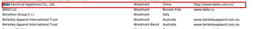

Enteresan bir döküman buldum :
ARCELIK-BEKO
BSCH grubu da bu sertifikaya sahipmiş??
Sadece Electrolux değil (Üzgünüm)
https://www.woolmark.com/certification/current-woolmark-licensees/
https://www.woolmark.com/globalassets/woolmark/woolmark-logo/woolmark-certification/current-woolmark-licensees/woolmark_active_licences_20180301.pdf/
