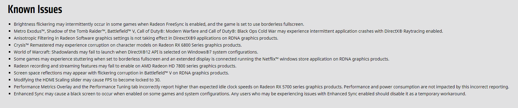

Known Issues
  • Brightness flickering may intermittently occur in some games when Radeon FreeSync is enabled, and the game is set to use borderless fullscreen.
  • Metro Exodus™, Shadow of the Tomb Raider™, Battlefield™ V, Call of Duty®: Modern Warfare and Call of Duty®: Black Ops Cold War may experience intermittent application crashes with DirectX® Raytracing enabled.
  • Anisotropic Filtering in Radeon Software graphics settings is not taking effect in DirexctX®9 applications on RDNA graphics products.
  • Crysis™ Remastered may experience corruption on character models on Radeon RX 6800 Series graphics products.
  • World of Warcraft: Shadowlands may fail to launch when DirectX®12 API is selected on Windows®7 system configurations.
  • Some games may experience stuttering when set to borderless fullscreen and an extended display is connected running the Netflix™ windows store application on RDNA graphics products.
  • Radeon recording and streaming features may fail to enable on AMD Radeon HD 7800 series graphics products.
  • Screen space reflections may appear with flickering corruption in Battlefield™ V on RDNA graphics products.
  • Modifying the HDMI Scaling slider may cause FPS to become locked to 30.
  • Performance Metrics Overlay and the Performance Tuning tab incorrectly report higher than expected idle clock speeds on Radeon RX 5700 series graphics products. Performance and power consumption are not impacted by this incorrect reporting.
  • Enhanced Sync may cause a black screen to occur when enabled on some games and system configurations. Any users who may be experiencing issues with Enhanced Sync enabled should disable it as a temporary workaround.
