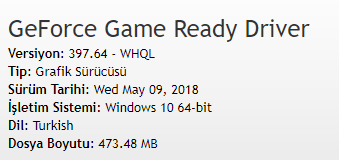

NVIDIA GeForce 397.64 WHQL sürücüsü çıkmış.
Game Ready Drivers provide the best possible gaming experience for all major new releases, including Virtual Reality games. Prior to a new title launching, our driver team is working up until the last minute to ensure every performance tweak and bug fix is included for the best gameplay on day-1.
Game Ready
Provides the optimal gaming experience for Destiny 2: Warmind, Conan Exiles, and Pillars of Eternity II: Deadfire
7 yıl
Deneyenlerden yorumları bekliyoruz
