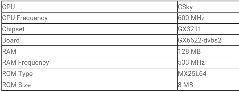

Cihazın teknik bilgilerini paylaşayım ;
İşlemci ; GX6622 yada GX6611
( İki işlemcinin de özellikleri aynı.
GX6622'de "advanced security" özelliği,
GX6611'de "BGA advanced security" olarak belirtilmiş. )
RAM ; DDR3 256 MB.( Kesinlikle 256 MB. )
Flash bellek ; 128 MB.
Tuner ; RDA5815M
Demodülatör ; GX113X ( Multistream kanalları hangi koşullarda açacağı belli değil ! Yani "root" değeri girilmeye imkan verip vermediğini bilinmiyor... )
[ 0.000000] Linux version 3.0.8 (rain@rain) (gcc version 4.5.1 (C-SKY Tools V2.8.01-gx-sp3(UClibc), ABIV1, B20150413) ) #3 PREEMPT Wed Nov 15 19:57:27 HKT 2017
[ 0.000000] Linux C-SKY port done by C-SKY Microsystems co.,ltd. www.c-sky.com
[ 0.000000] CPU revision is: 0x102816a2 (CK610MA)
[ 0.000000] Determined physical RAM map:
_______fe_auto_detect_parse________
[ 310.840000] tuner[0].tuner_i2c_id = 0
[ 310.840000] tuner[0].tuner_chip_addr = 0x18
[ 310.840000] tuner[0].tuner_type = RDA5815M
[ 310.840000] demod[0].demod_i2c_id = 0
[ 310.840000] demod[0].demod_chip_addr = 0xe4
[ 310.840000] demod[0].demod_type = GX113X
[ 310.930000] [1;33mdemod[0]-GX113X, tuner[0]-RDA5815M detect OK!
[ 310.930000] [mtuner[1].tuner_i2c_id = 1
[ 310.930000] tuner[1].tuner_chip_addr = 0x18
[ 310.930000] tuner[1].tuner_type = RDA5815M
[ 310.930000] demod[1].demod_i2c_id = 1
[ 310.930000] demod[1].demod_chip_addr = 0xd0
[ 310.930000] demod[1].demod_type = GX113X
[ 311.010000] [1;33mdemod[1]-GX113X, tuner[1]-RDA5815M detect OK!
[ 311.010000] [m [1;33m_______profile : |4:0:0xe4:55:0:0x18:&1:1:2:0|4:1:0xd0:55:1:0x18:&0:1:8:1
[ 311.010000]
[ 311.010000] [mfe_profile.demod_type = GX113X
[ 311.010000] fe_profile.demod_i2c_id = 0
[ 311.010000] fe_profile.demod_chip_addr = 0xe4
[ 311.010000] fe_profile.tuner_type = RDA5815M
[ 311.
010000] fe_profile.tuner_i2c_id = 0
[ 311.010000] fe_profile.tuner_chip_addr = 0x18
[ 311.010000] fe_profile.iq_swap = yes
[ 311.010000] fe_profile.hv = 1
[ 311.010000] fe_profile.tspin = 2
[ 311.010000] fe_profile.serial = no
[ 311.010000] demod 0 chip type : 0x1133
[ 311.030000] DVB: registering frontend 0 (Nationalchip GX3211 DVB-T2 S2)...
[ 311.030000] fe_profile.demod_type = GX113X
[ 311.030000] fe_profile.demod_i2c_id = 1
[ 311.030000] fe_profile.demod_chip_addr = 0xd0
[ 311.030000] fe_profile.tuner_type = RDA5815M
[ 311.030000] fe_profile.tuner_i2c_id = 1
[ 311.030000] fe_profile.tuner_chip_addr = 0x18
[ 311.030000] fe_profile.iq_swap = no
[ 311.030000] fe_profile.hv = 1
[ 311.030000] fe_profile.tspin = 8
[ 311.030000] fe_profile.serial = yes
